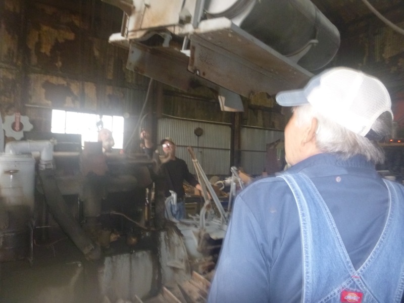

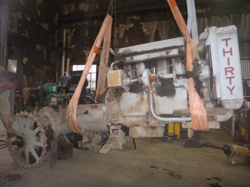

Last Friday and Saturday Loma and I traveled to Cushing Oklahoma, and helped Scott Kuhns and several others, work on Scott's 1928 Thirty. It had developed a suspicious "growl" in the rear end/transmission.

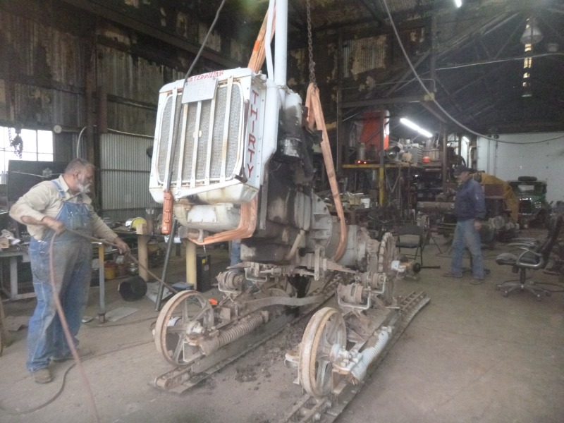

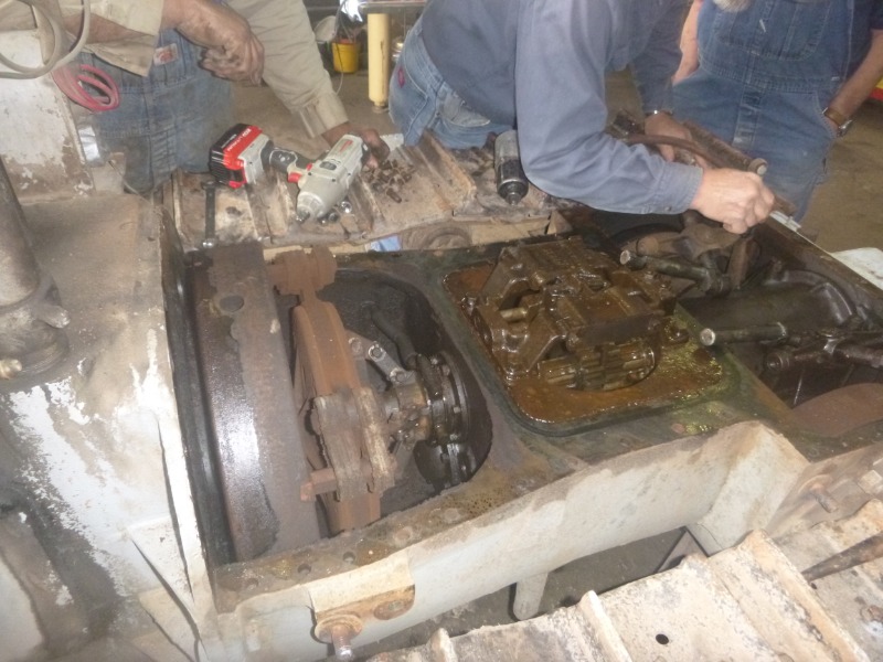

Friday morning we got it in the shop and began dis-assembling. Fortunately / unfortunately, in the service book, nearly all operations begin with remove platform, tracks and track frame, final drives etc etc.

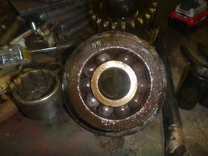

After removing the platform we took off the top of tranmission. Not finding any obvious problems, we moved on. Tracks and track frames, gone.Saturday morning began. Final drive housings sprockets, gone. Ring gear and steering clutch packs, gone. After quite a bit of torch action, top shaft in trans, gone. After more long cheater pipe AND torch action, bottom shaft in trans. gone, BUT we found the growl. The front bearing had lost the cage around the balls in the bearing. Little pieces of it were floating around in the bearing cage cap..
